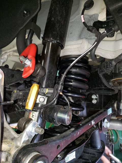

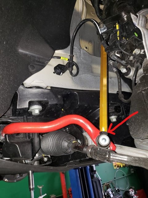

That clunking noise you hear is from the endlinks, you need to put loctite on all eight of the treads of the lock nuts the torque them down. Here's a photo of what I'm talking about..
I heard the same thing from my whiteline endlinks, when you loctite them down an torque them let the car sit over night to set an you should be good..

Question. How much adjustment did tou have to do from the stock length?
Sent from my SM-G965U using Tapatalk
That photo of the front endlink is set to stock length, the rear I set to stock length but when I had my aftermarket rims installed I had to make them shorter "close up" so the sway bar wouldn't hit the inside of the rim why the car is off the ground..
