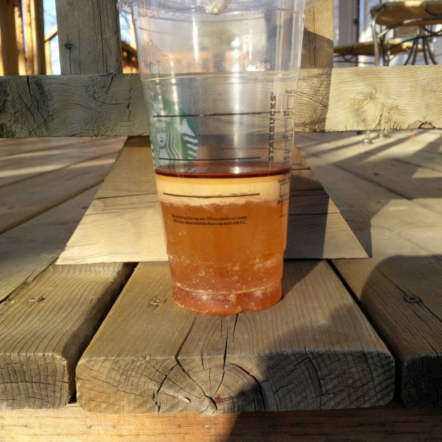

My car is stock tune and I dump out the catch can at every oil change. I use to drive a lot of highway miles so the build up wasn’t too much, maybe 4-5oz per oil change. Now my driving is a lot less because of having a job closer to home (PTL!), so I haven’t checked it in a few months.
When I would change it out it would definitely be a good mix of oil and water. One time it had a lot of milky sludge in the bottom.
