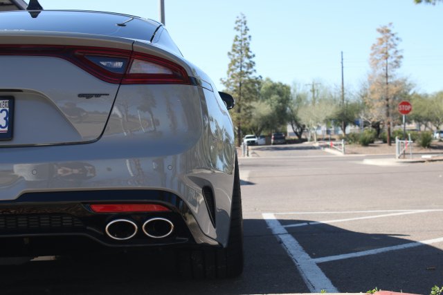

I'm on Eibach springs, RWD & I have the stock camber adjusted all the way which is 1.7 but the springs settled an I do believe it's at 1.9. You will be fine as long as your not out burning the tires off... It's hard to tell but here's a picture..

ok cool. just wanted to make sure I was doing the best I could do with the stock hardware. Mine looks about like that. I've had my last 6 cars dropped and it always results in a bit too much negative camber in the rear. I'm used to it basically. thanks for the reply.
