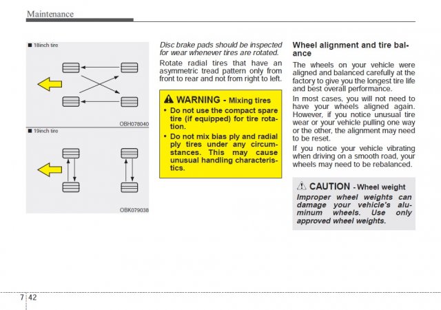

You can rotate the tires on the Base model. I got 3 years oil changes and rotations at my dealer.

It seems you aren't aware the Stinger GT is available with uniform sized 18" front and back wheels/tires ...
Hello I drive a2019. Gt 1 my front tires are a size 225/40/ 19. Rear tires are 255/35. When it comes time for balancing they will stay when installed from the factory.
Heh there. I drive a 2019 Stinger GT AWD and both my front and rear tires are 225/45 18. They've been rotated as per manufacturer's recommendations.

Tires are obviously different sizes on different model stingers. I was with what was installed on my 2019 GT1 RWD. Enjoy your stinger
