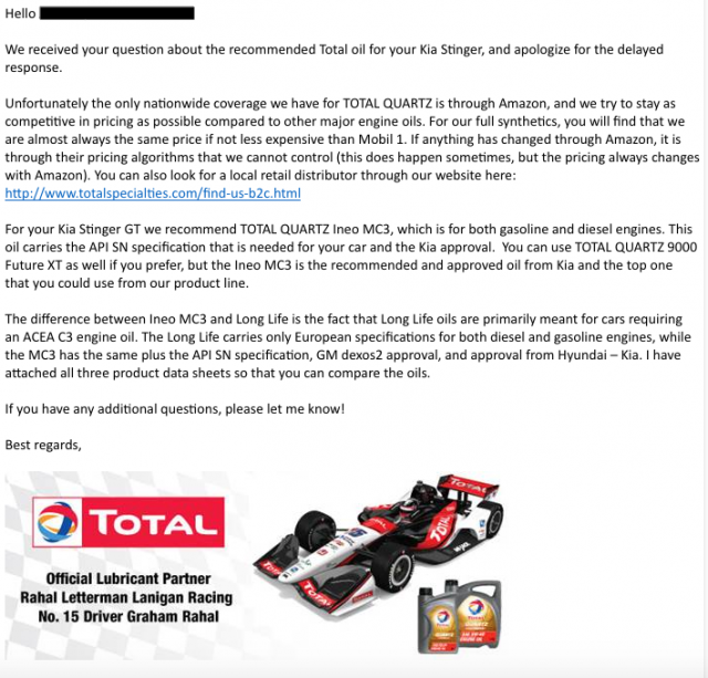

The manual says "Total" which is not available (as far as I know) in the U.S. I'm sure it's a synthetic.
I asked my dealer's service manager last week and he said Total Quartz. I assume it's the 5w40. He did give me the "It's a special oil designed specifically for that engine". Oakey Dokey. But it does look like a quality product.
I do all my own maintenance on my Mercedes and Tacoma and always stick with the mfg. spec on the fluids. MB has a whole BEVO web site just for fluid specs which takes the guess work out of it. I run Mobil1 0w40 Euro in the Benz and Valvoline or Castrol 5w30 dino oil in my Taco with 200k on it.
https://www.amazon.com/Total-184952...ocphy=1022639&hvtargid=pla-571108952316&psc=1
